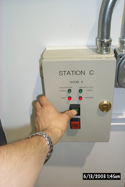

- Each station has one or more numbered search boxes inside. Each box has a button that must be pressed as the search of the station progresses. When the conditions listed above are met, an amber light will start flashing above the first search box.
- Check the area around the first search box for people. When there are no people present, press the button on the box. If the station has multiple search boxes, an amber light will begin to flash over the box for the next area to be searched. During this process, a voice warning and a red strobe light will indicate that a search is in progress.
- After all search box buttons have been depressed and the station carefully searched for no remaining personnel, exit the station and close the door(s) by pushing the DOOR CLOSE button until the green closed LED indicator is lit. The DOOR CLOSE button can then be released. Watch to make sure that no one enters the station during this time.
If a Search-and-Secure has been correctly performed, a steady green LED STATION SEARCH (or SECURE) light will be seen on the Station Control Panel. The manual and pneumatic door indicator LEDs will be lit to show the doors closed and locked.
