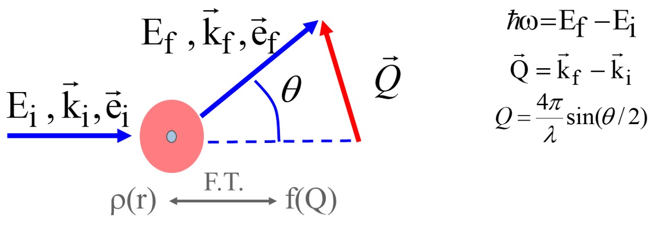

Scattering Process for X-rays
A general scattering process can be shown as in the following figure and valid for probes like neutrons, photons and electrons.
Incident photon of initial energy of well-defined Ei, momentum ki , and polarization ei impinges on a target.  Target is an atom which consists of nucleus and electrons.  Then, incident beam is scattered by these electrons to different state (by Ef, kf, ef) and we can observe the scattered intensity at certain scattering angle theta in a certain solid-angle element dW.
IXN scattering process​

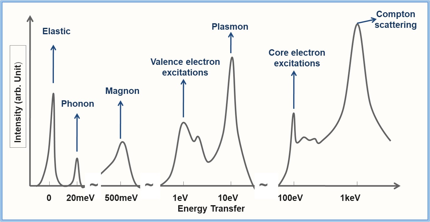

The spectrum, S(Q,w), as a function of energy and momentum transfer gives direct information on excitations specific to the studied system.
  • In the case of elastic scattering, Ei = Ef , S(Q,w=0)
    • One can study the structural properties of the system.
  • In the case of inelastic scattering, Ei ≠ Ef
    • Dynamical and electronic properties of the system can be studied.
    • Provides access to very rich excitation spectra; phonon, magnon, …
Intensity vs Energy Transfer​

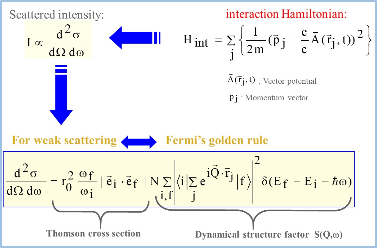

Partial Differential Cross Section
The scattered intensity is described by the partial differential cross section which can be calculated by considering the interaction Hamiltonian of the scattering system.
Scattered intensity​
For weak scattering process, it can be written in terms of the Fermi’s Golden rule.
  • First part is the Thomson cross section which describes the coupling of the electromagnetic field to the scattering system.
  • And rests of the terms are called as Dynamical Structure Factor, S(Q,w), which depends on the properties of the studied system.
J. J. Sakurai, Advanced Quantum Mechanics, Addison-Wesley Publishing Company, New York, pg. 20-57,1967.

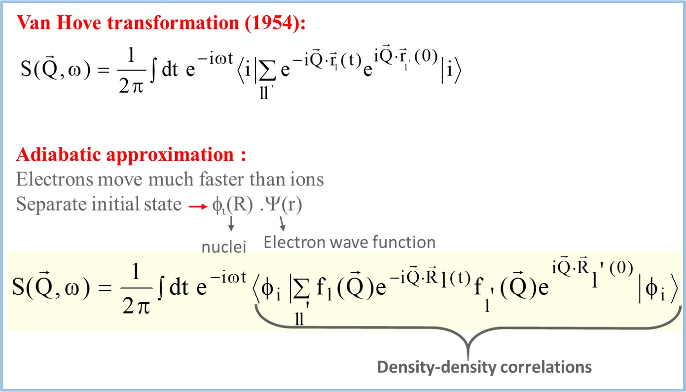

Dynamical structure factor can also be represented as time Fourier transform of the density-density correlations function at different times for the same initial and final states by using van-Hove transformation.
Within the adiabatic approximation, it can be expressed as density-density correlation at different times for the same nuclei state.  And f is the atomic form factor that depends on the electron wave function.
Van Hove transformation​

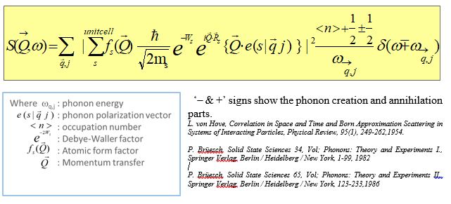

At the end, dynamical structure factor for one phonon case can be written as follows:
IXS

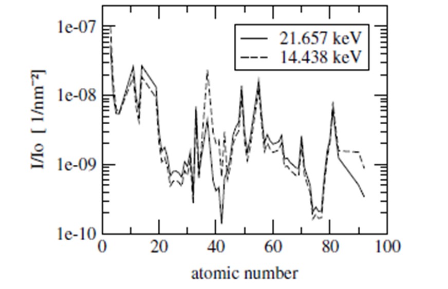

Expected Phonon Intensities (Phonon Cross Section)
Scattered intensity ​
where dQ is the momentum resolution, Ei is the incident energy, Z is the number of electrons, Iabs is the absorption length chosen for the optimum thickness, r is the number and ns is the sound velocity.
IXS
Expected phonon intensities for different elements in forward scattering, normalized to the incident flux on the sample and 1 nm−2 momentum resolution for two incident energies at 14.4 and 21.6 keV.  As seen in this figure, phonon cross section is too low and presents a real challenge for inelastic x-ray scattering .
H. Sinn, Spectroscopy with meV energy resolution,  J. Phys.: Condens. Matter,13, 7525, 2001
