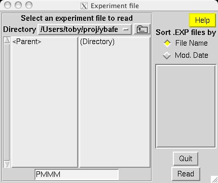

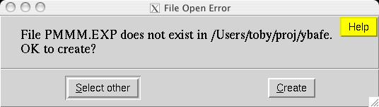

The first step in the refinement is to start a new refinement by creating a new experiment file. Start EXPGUI and enter a new file name (screen image) then click on the "Create" button to then create a new, empty, experiment file (screen image) and enter a title.

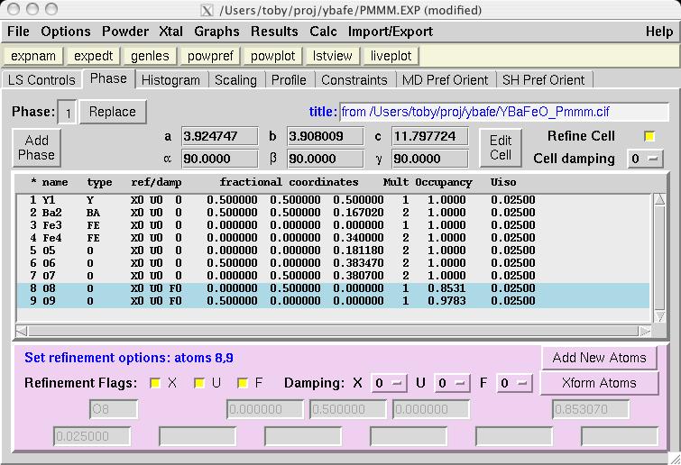

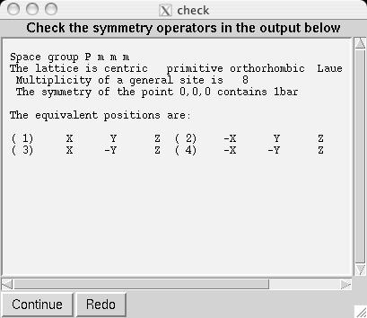

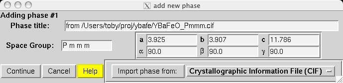

The first step in creating an GSAS refinement is to create a phase. This can be done from this information:
Atom positions as fractional coordinates for
YBa2Fe3O8.
Space group: Pmmm
Lattice constants: a=3.925, b=3.907, c=11.786
Element Label x y z Occupancy
Y Y1 0.5 0.5 0.5 1
Ba Ba1 0.5 0.5 0.167 1
Fe Fe1 0 0 0 1
Fe Fe2 0 0 0.34 1
O O1 0 0 0.181 1
O O2 0.5 0 0.383 1
O O3 0 0.5 0.380 1
O O4 0 0.5 0 0.853
O O5 0.5 0 0 0.978

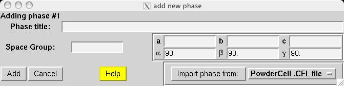

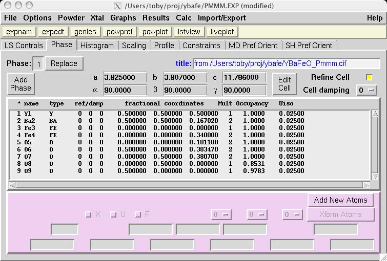

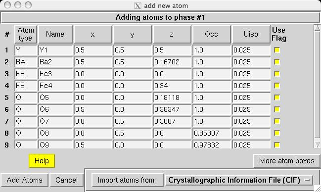

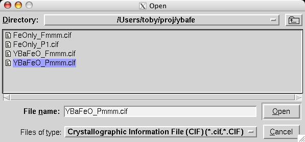

Considerable typing can be avoided by importing the phase from a provided CIF, YBaFeO_Pmmm.cif in file YBAFEO.zip.

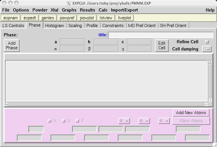

Go to the Phase panel (screen image) and press the "Add Phase" button. To input the information from the CIF, click on the "PowderCell .CEL file" menu button to bring up a menu of choices (screen image) and select "Crystallographic Information File (CIF)" which brings up a window where the file YBaFeO_Pmmm.cif can be selected. (screen image); click on "Open" after the file is selected. Click on "Continue" on the add new phase (screen image) and on the Check symmetry windows (screen image) and then "Add Atoms" on the Adding atoms... window (screen image) and the phase has been added, just like that. Finally, make sure the "Refine Cell" option is not selected, (screen image) so that the unit cell parameters will be refined until later, after the background and scale factor are first brought into the right range.

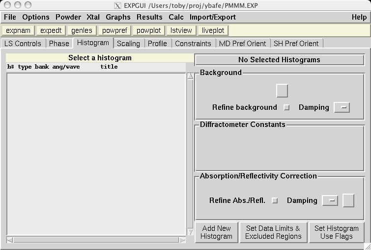

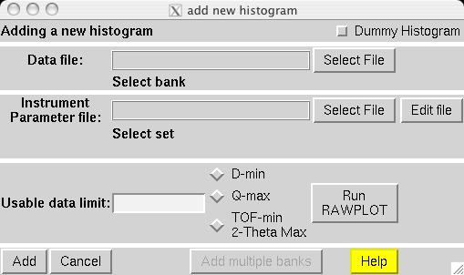

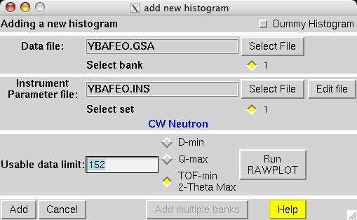

Input Diffraction Data

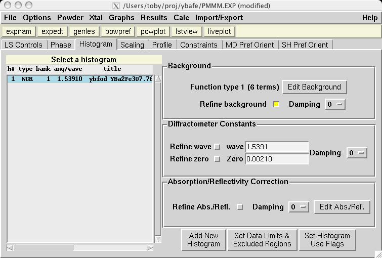

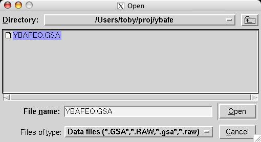

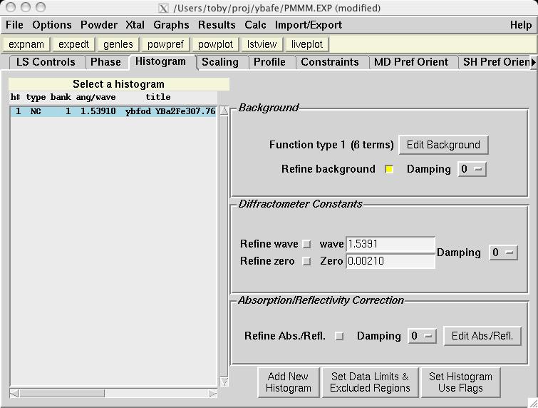

The second step in almost every GSAS refinement is to input diffraction data (or select data parameters in a simulation). This is done from the Histogram panel (screen image). Click on the "Add New Histogram" button which brings up the add new histogram window (screen image). Press the Select file to select the appropriate GSAS data file in the Open window (screen image); press the open button and the file names for the both the data file and the instrument parameter files are loaded (you might see messages about file conversions if the download process has stripped non-printing characters needed from the files.). Finally, change the data range to utilize a maximum two-theta of 152 degrees on the add new histogram window, which eliminates the last very wide peak from use in the refinement (the fit would also progress well were this peak included) (screen image). Press "Add" on this window and the diffraction data are now included in the refinement Finally, change the background function to type 1 with 6 terms by pressing the "Edit Background" button (this is the authors' preference -- but other settings could be selected.) (screen image). Finally, confirm that the "Refine background" option is selected so that the background will be fit (screen image).

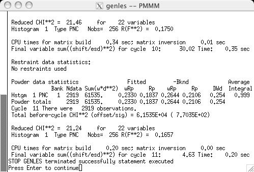

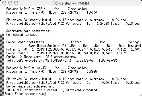

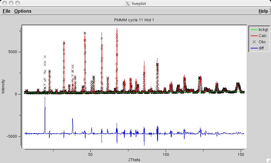

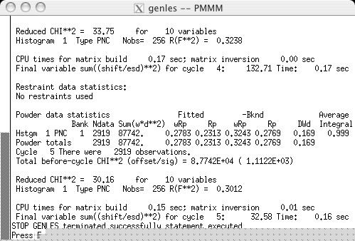

Start Initial Fit of Experimental Parameters

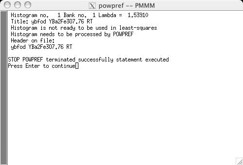

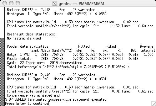

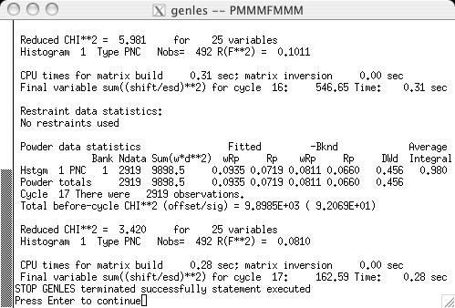

The fit can now be started, by pressing the "powpref" (screen image) and "genles" buttons (screen image). Note that pressing each button starts a program in another window and then (unless the default settings have been changed) after each run has been completed, the extra window is closed and the "Load New" button is pressed on the Reload screen (screen image). Note that after the two cycles of refinement, the chi2 value drops to approximately 44.

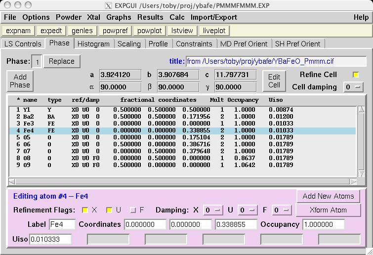

At this point the unit cell is refined, by selecting the the "Refine Cell" option on the Phase panel (screen image). Press the "genles" button and note that the fit improves to a chi2 value of approximately 30 (screen image). The two-theta zero is now refined using the "Refine zero" control on the Histogram panel (screen image). Press the "genles" button and note that the fit improves to a chi2 value of approximately 28.
Start Initial Fit of Structural Parameters

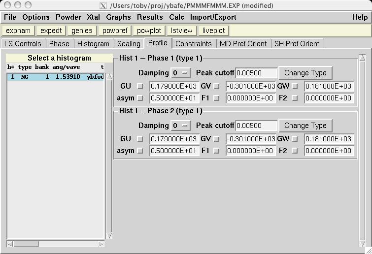

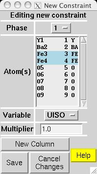

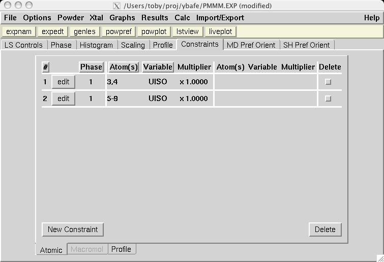

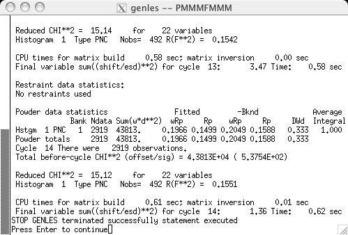

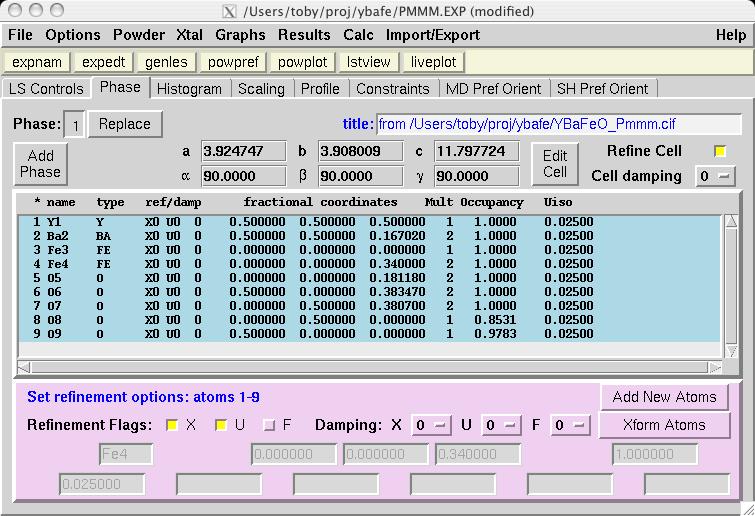

At this point an initial fit of the structure is performed (although some researchers might delay this until the magnetic modeling is included). While under normal conditions, it would be wise to add refinement of variables over the course of several refinement runs, in this case the model is quite stable with respect to refinement and this can be done in a single run. Before starting the refinement, however, Uiso values for like element types are grouped together to reduce the number of parameters. This is done with the Constraints panel (screen image). To set up the constraint on the Fe atoms, Press on the "New Constraints" button, then select them by dragging over them with the mouse and select UISO in the Variable menu button (screen image) and press "Save". Repeat this with the O atoms, Press on the "New Constraints" buttton by dragging over those atoms with the mouse; then select UISO in the Variable menu button (screen image) and press "Save". The Constraints panel will then list the two constraints (screen image).
To refine the nuclear model, select all atoms on the phase panel (the right mouse button will do this) and click on the X and U "Refinement Flag" buttons (screen image) so that all atom positions can be optimized in addition to 4 Uiso values (1 for the Fe atoms, 1 for the O atoms, 1 for the Y atom and 1 for the Ba atom). Note that the atom positions will only be optimized as far as allowed by symmetry, so the Ba position at (1/2,1/2,1/2) will not actually change. Then set the F (fractional occupancy) flag for O8 and O9 only (screen image). Press the "genles" button and note that the fit improves to a chi2 value of approximately 21 (screen image). A view of the fit in LIVEPLOT shows the profile terms need some refinement (which will be done later) and there is significant missing intensity for several low angle reflections (screen image) -- not surprising, since magnetic scattering is not included.

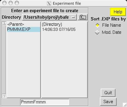

Save work under new name
Before going any further, lets save the project under a new name, so that it is easy to compare later work to the non-magnetic model, or so that it is easy to go back to this point to proceed with an alternate magnetic model. To do this, use the "Save As" option in the EXPGUI "File" menu item. This opens an experiment file window, where the new name to be used is specified (screen image). The name PmmmFmmm was selected here, since the nuclear structure will be modeled in space group Pmmm and the magnetic structure in Fmmm and a new experiment file, named PMMMFMMM.EXP is created.

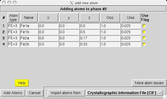

To add a separate magnetic phase, the phase will be added as a standard (nuclear scattering-only) phase using EXPGUI, then EXPEDT is used to change a flag so that it contribributes only as a magnetic scatterer. Also, constraints on atomic, unit cell and profile parameters are needed. Some of these values can be set from EXPGUI, but others must be set from EXPEDT.
The magnetic phase is described using:
magnetic atoms in YBa2Fe3O8.
Space group: Fmm'm'
Lattice constants: a=2an, b=2bn, c=2cn
Element Label x y z Moment
Fe+3 Fe1a 0 0 0 3.5
Fe+3 Fe1b 0 0 0.5 -3.5
Fe+3 Fe2a 0 0 z/2 -3.5
Fe+3 Fe2b 0 0 0.5-z/2 3.5
Note that in the above an (etc.) refers to the a dimension of the primitive, nuclear cell and z is the coordinate of the second Fe atom. Thus, before starting, make note of the unit cell parameters (a, b & c) in the initial nuclear phase as well as the z coordinate of the second Fe atom and its Uiso value. (screen image).

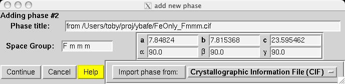

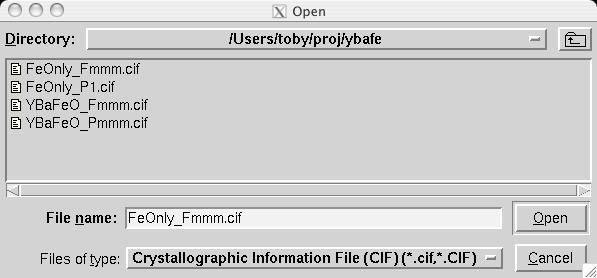

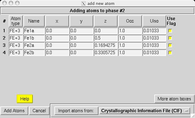

As before, to save time, the basic phase information can be read from a CIF, FeOnly_Fmmm.cif in file YBAFEO.zip, though in this case some editing of the input information will be needed.

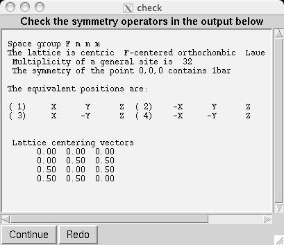

  • First, the phase is loaded by clicking on the "Add Phase" button on the Phase panel. To input the information from the CIF, click on the "PowderCell .CEL file" menu button to bring up a menu of choices and select "Crystallographic Information File (CIF)" which brings up a window where the file FeOnly_Fmmm.cif can be selected. (screen image); click on "Open" after the file is selected.
  • In the add new phase window, change the a, b & c parameters to be twice those of the first phase, then click on "Continue" on the add new phase (screen image). Also, press "Continue" on the Check symmetry window (screen image). This causes the Adding atoms... window to be displayed. (screen image). In this window, change the z coordinate for atoms Fe2a and Fe2b based on the z coordinate of the second Fe atom. Also change the Uiso value ot agree with the Uiso values for the atoms in phase 1 (screen image) Finally, press the "Add Atoms" button on this window to add the phase.

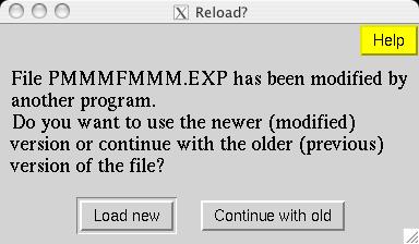

To change the flag for the second phase, the EXPEDT program is used. This can be invoked from EXPGUI, by pressing the EXPEDT button or from the Powder and Xtal menus. In EXPEDT, use the following commands:
  1. Y
  2. P
  3. P
  4. m 2
  5. c
  6. x x x x
where command 1) [Y] indicates the correct file has been selected to be edited; command 2) [P] enters the powder menu; command 3) [P] moves from the powder to the phase edit submenu; command 4) [m 2] selects the second phase to have the magnetic flag changed; command 5) [c] sets the phase to be magnetic-only; command 6) [x x x x] returns to the main menu. Note that 4 "x" characters are not needed in the final command, but extra characters are ignored.

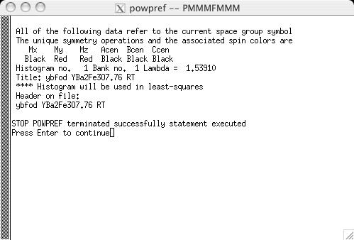

In the previous step, phase 2 was flagged as magnetic, but before a magnetic scattering computation can be performed, the magnetic symmetry needs to be set. In this case, two operator colors must be changed to change the space group from Fmmm to Fmm'm'. Once the magnetic symmetry is established, the magnetic moments for each magnetic atom are supplied.
  1. L A
  2. P 2
  3. M
  4. S
  5. c 2
  6. c 3
  7. x
  8. m 1 3.5
  9. m 2 -3.5
  10. m 3 -3.5
  11. m 4 3.5
  12. x
  13. L
  14. x x x x

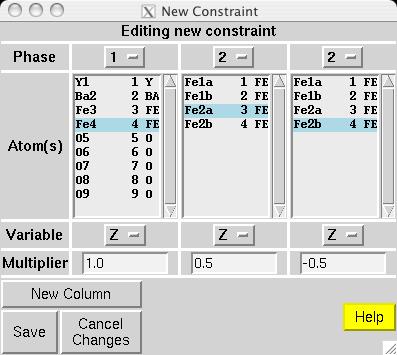

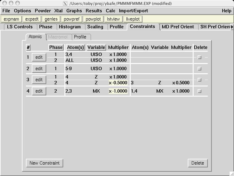

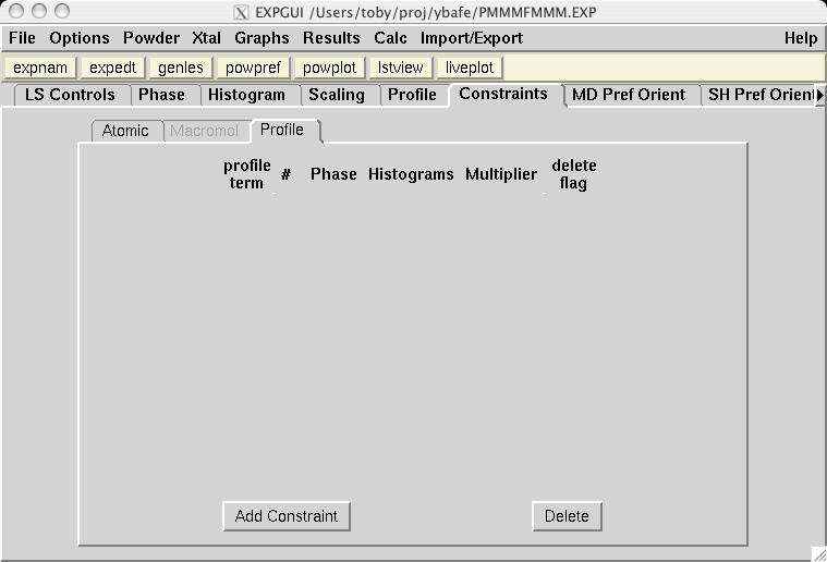

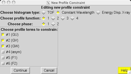

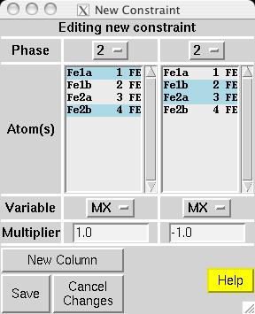

Setup Cell Constraints
So that the unit cell for the two phases will not be treated as independent variables, constraints are needed to force the two sets of unit cell parameters to change together. Note that since the second phase has dimensions double to that of the first, the shifts applied to the second phase should be double that of the first. However, the actual parameters that GSAS refines are not lattice parameters, but rather are the reciprocal metric tensor terms, where the diagonal terms, RM11, RM22 & RM33, are equal to a*2, b*2 and c*2. Since the ratio of (a*N2):(a*M2) is 4:1, we use this ratio for our shifts. In EXPEDT, use the following commands:
  1. L
  2. O
  3. L
  4. K
  5. I 1,RM11,4 2,RM11,1 (+blank line)
  6. I 1,RM22,4 2,RM22,1 (+blank line)
  7. I 1,RM33,4 2,RM33,1 (+blank line)

After the EXPEDT window is closed since EXPEDT has changed the experiment file, (unless the Autoload EXP option is set) there is a prompt to load the information from this changed file: press the "Load new" button to continue (screen image).

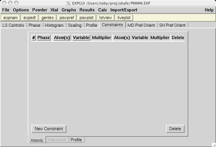

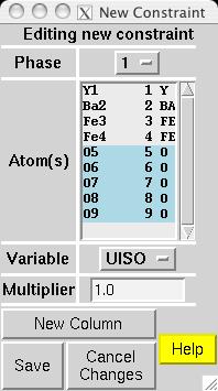

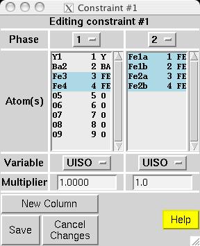

Setup Atomic Constraints
The Fe2a & Fe2b atoms in the magnetic phase should move in concert with the Fe4 atom in the nuclear phase, where the shift on Fe2a will be 50% the shift on Fe4 and the shift on Fe2b will be -50% of the shift on Fe4. This is done on the Constraints menu, by pressing the "New Constraint" button to open the Edit Constraint window. Press the "New Column" button twice to create a second and third constraints subwindow. Select Phase 1, Fe4, variable Z and multiplier 1.0 in one column, Phase 2, Fe2a, variable Z and multiplier 0.5 in another column, and Phase 2, Fe2b, variable Z and multiplier -0.5 in the remainined column (screen image). Then press the "Save" button to enter the new constraint. (Note that multipliers have an arbitrary scale; multipliers of -2,-1,1 would provide equivalent results.)
    Likewise, the constraint on the Uiso for the Fe atoms is expanded to include the Fe atoms in the second phase. This is done by clicking on the first "edit" button to amend the first constraint. On the Editing Constraint #1 window, press the "New Column" button, select Phase 2 in the new column, select all atoms; the Variable selection defaults to Uiso and the Multiplier value defaults to 1.0 (screen image). Then press the "Save" button to enter the modified constraint (screen image).

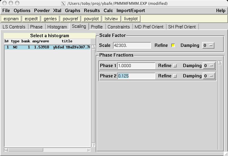

Constrain Phase Fractions
GSAS scale factors are proportional to the number of scatters present in the unit cell. Since the unit cell of the magnetic phase is eight times larger than that of the nuclear phase, the scattering from this phase will be over counted. To prevent this (so that magnetic moments are scaled properly with respect to the nuclear scattering), the phase fraction of the second phase is lowered by the ratio of the unit cell volumes (1/8). This is done by changing the Phase Fraction for Phase 2 on the Scaling panel (screen image). Make sure that the scale factor is refined, but not either of the phase fractions.
Phase 2 Refinement Flags
Constraints have been established on the unit cell and the atomic parameters of phase 2. It is important to set the refinement flag and damping values to be the same for constrained parameters. Since unit cell paremeters, Uiso values and Fe4 z are refined in phase 1, the same must be done in phase 2. On the phase panel, select phase 2, noting that EXPGUI now shows that the phase is magnetic-only directly below the phase selection buttons.
  • Click on the "Refine Cell" checkbutton.
  • Also, turn on the X and U flags, so that the z coordinates of the Fe atoms and the Uiso values will follow the atoms in the nuclear phase, by highlighting all atoms and selecting the "X" and "U" checkbuttons (screen image).
    Note that the first two Fe atoms in the magnetic phase will not change position regardless of the X flag, as they are on special positions with no degrees of freedom.

Since a new phase has been added to the refinement, it is necessary to run POWPREF (screen image). and then GENLES (screen image). The fit improves from the previous chi2 value of approximately 21 to a new value of approximately 15, as the low-angle magnetic lines are now computed with more intensity, as can now be seen in LIVEPLOT (screen image).

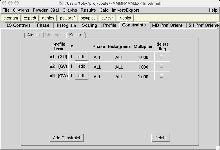

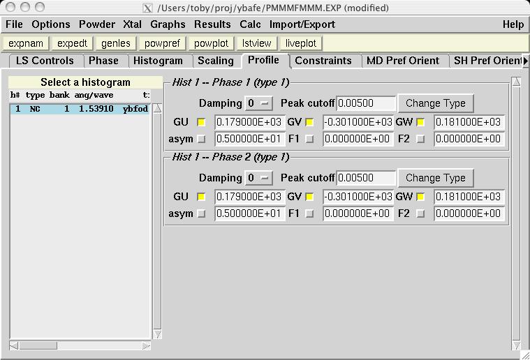

Constrain and Refine Profile Constraints
From the previous LIVEPLOT result, it is clear that the profile is a major source of differences between the observed and computed diffraction data. While it is possible to have different ordering ranges for the nuclear and magnetic ordering, in most cases, it is best to have the same parameters, for both the nuclear and magnetic phases.

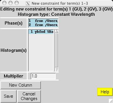

A quick check of the Profile panel shows that the profile termes are the same for both phases because they are still at their default values, having not been refined. (screen image). To constrain the profile terms to refine to be the same, select the Constraints panel and the click on the lower Profile tab and then press the "Add Constraint" button (screen image). This will open the New Profile Constraint window (screen image). Select GU, GV & GW to be constrained (none of the other terms need to be refined); then press the "Continue" button. In the next window, select both phases in the top part of the window and press the "Save" button (screen image). This generates the constraints, which show up on the Constraint panel (screen image).
Select the check buttons for GU, GV & GW in both phases (screen image) and then start GENLES (screen image). The fit improves from the previous chi2 value of approximately 15 to a new value of approximately 3.4. Running POWPREF and then GENLES again causes chi2 to drop from 3.4 to 2.6 just due to the expansion of the peak shape range from POWPREF. Subsequent refinement cycles improves chi2 slightly, to 2.45 (screen image).
Constrain & Refine Magnetic Moment
n most magnetic refinements, one wishes to refine magnetic moments. It should be noted that the Fe1a and Fe1b atoms are symmetry related, as is the case for Fe2a and Fe2b. One could consider treating the two Fe1 atoms as having different moments from the two Fe2 atoms, but this makes little chemical sense, since there is no reason to expect either site to have an accumulation of off-valence Fe atoms. Further, due to the pseudo-symmmetry of the cell, there are few reflections that distinguish the two non-equivalent Fe scatterers. Thus, it is best to treat all Fe atoms as having a single magnetic moment. EXPGUI can be used to set up constraints on the magnetic moments, by creating a new atom constraint on the Constraints panel, where a shift multiplier of 1.0 is applied to MX of atoms 1 & 4 in phase 2 and a shift multiplier of -1.0 is applied to MX of atoms 2 & 3 in phase 2 (screen image). Press the "Save" button and the constraint appears (screen image).
Changing the refinement flag for the magnetic moments must currently be done from EXPEDT, using the following commands:

The refinement is then started with GENLES. The magnetic moments shift only slightly (as can be seen from the LSTVIEW output) and the chi2 value drops only slightly (screen image).
