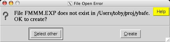

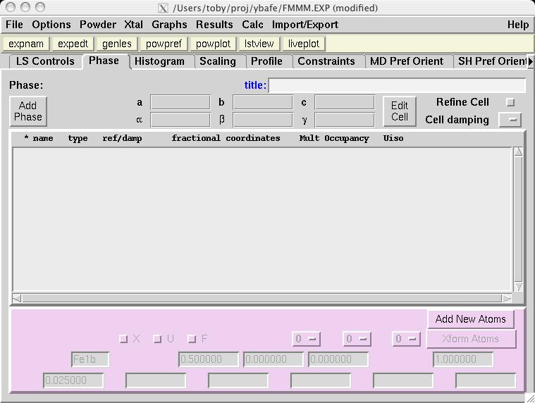

The first step in the refinement is to start a new refinement by creating a new experiment file. Start EXPGUI and enter a new file name then click on the "Create" button to then create a new, empty, experiment file (screen image) and enter a title.
The first step in creating an GSAS refinement is to create a phase. This can be done from this information:

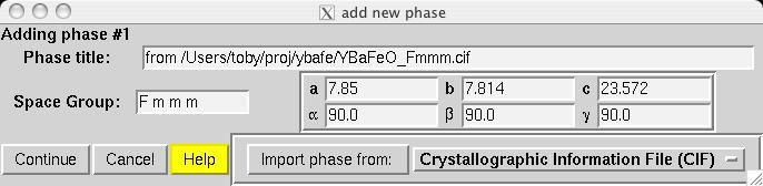

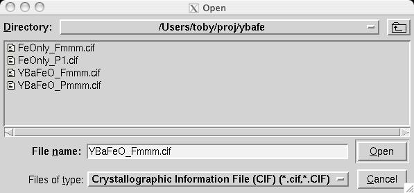

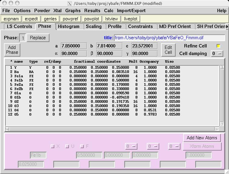

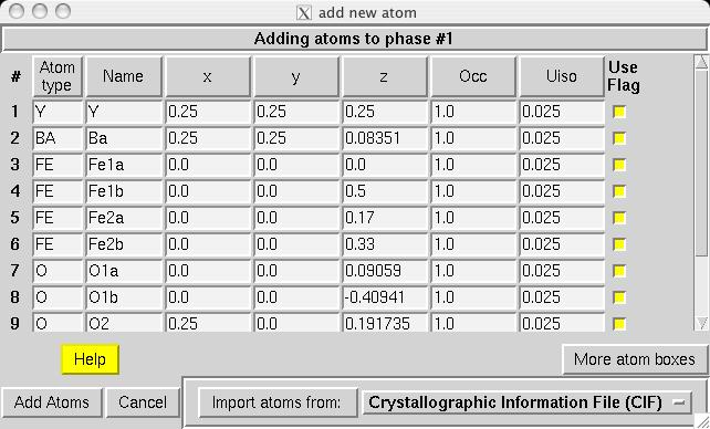

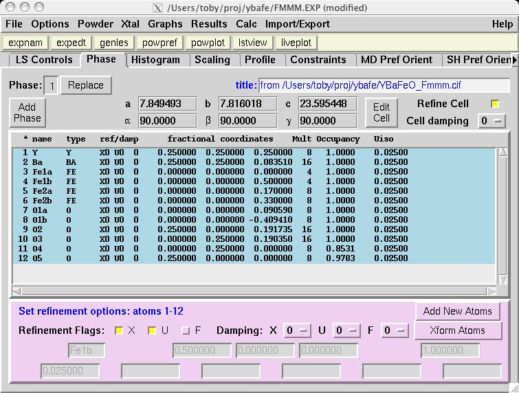

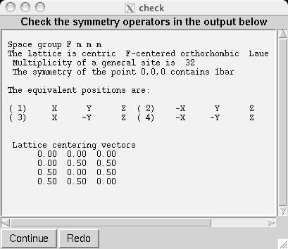

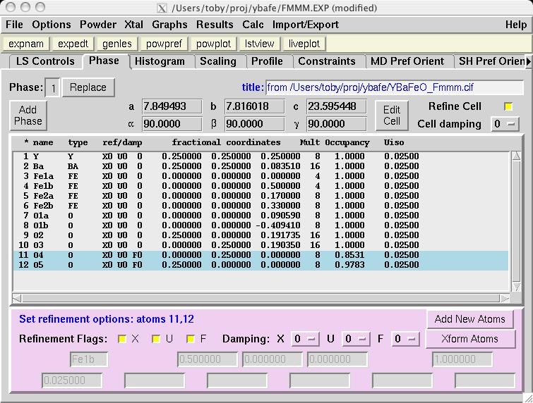

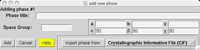

Go to the Phase panel (screen image) and press the "Add Phase" button. To input the information from the CIF, click on the "PowderCell .CEL file" menu button to bring up a menu of choices (screen image) and select "Crystallographic Information File (CIF)" which brings up a window where the file YBaFeO_Fmmm.cif can be selected. (screen image); click on "Open" after the file is selected. Click on "Continue" on the add new phase (screen image) and on the Check symmetry windows (screen image) and then "Add Atoms" on the Adding atoms... window (screen image) and the phase has been added, just like that. Finally, make sure the "Refine Cell" option is not selected, (screen image) so that the unit cell parameters will be refined until later, after the background and scale factor are first brought into the right range.

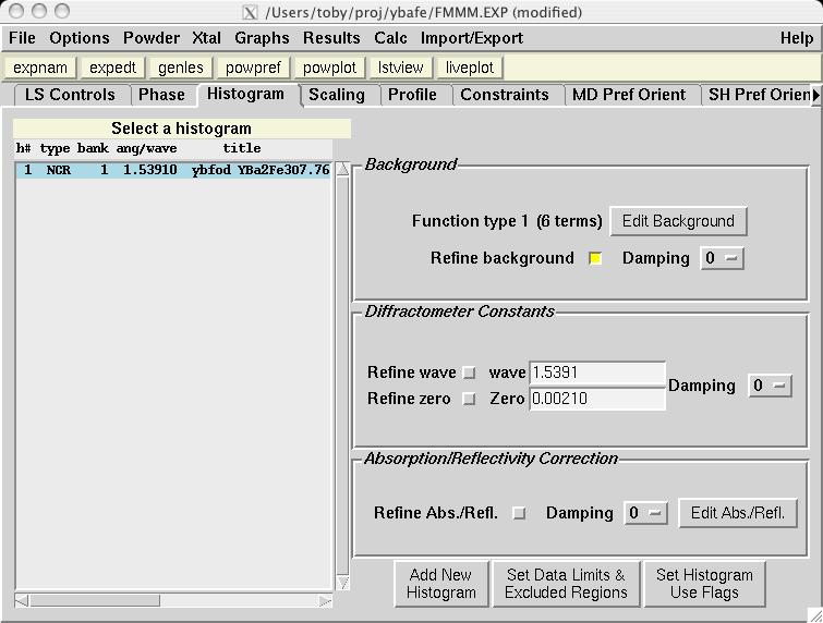

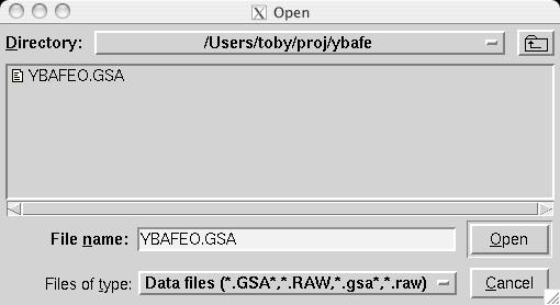

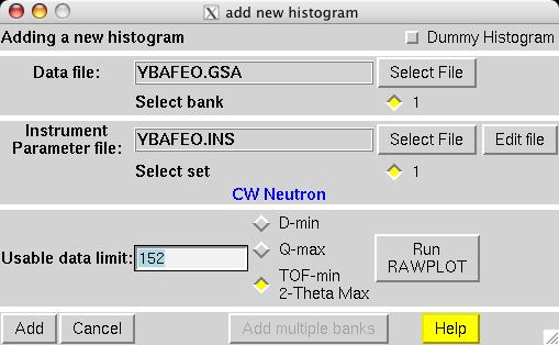

Input Diffraction Data

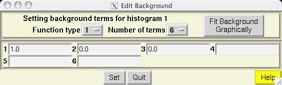

The second step in almost every GSAS refinement is to input diffraction data (or select data parameters in a simulation). This is done from the Histogram panel (screen image). Click on the "Add New Histogram" button which brings up the add new histogram window (screen image). Press the Select file to select the appropriate GSAS data file in the Open window (screen image); press the open button and the file names for the both the data file and the instrument parameter files are loaded (you might see messages about file conversions if the download process has stripped non-printing characters needed from the files.). Finally, change the data range to utilize a maximum two-theta of 152 degrees on the add new histogram window, which eliminates the last very wide peak from use in the refinement (the fit would also progress well were this peak included) (screen image). Press "Add" on this window and the diffraction data are now included in the refinement Finally, change the background function to type 1 with 6 terms by pressing the "Edit Background" button (this is the authors' preference -- but other settings could be selected.) (screen image). Finally, confirm that the "Refine background" option is selected so that the background will be fit (screen image).

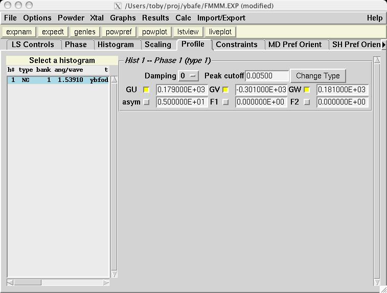

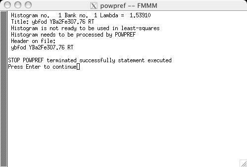

Start Initial Fit of Experimental Parameters

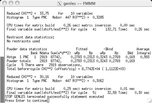

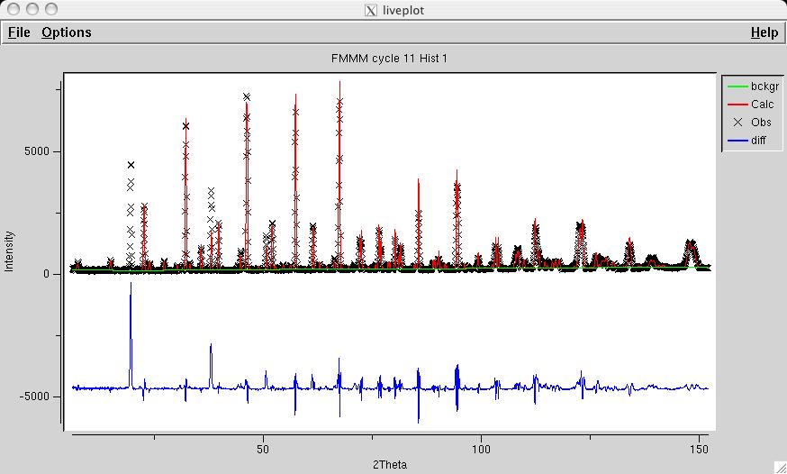

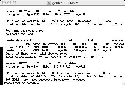

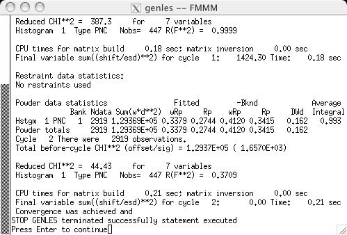

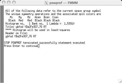

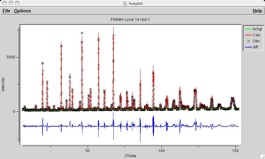

The fit can now be started, by pressing the "powpref" (screen image) and "genles" buttons (screen image). Note that pressing each button starts a program in another window and then (unless the default settings have been changed) after each run has been completed, the extra window is closed and the "Load New" button is pressed on the Reload screen (screen image). Note that after the two cycles of refinement, the chi2 value drops to approximately 44.
At this point the unit cell is refined, by selecting the the "Refine Cell" option on the Phase panel (screen image). Press the "genles" button and note that the fit improves to a chi2 value of approximately 30 (screen image). The two-theta zero is now refined using the "Refine zero" control on the Histogram panel (screen image). Press the "genles" button and note that the fit improves to a chi2 value of approximately 28 (screen image).

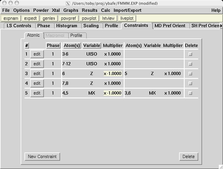

Constrain Structural Parameters

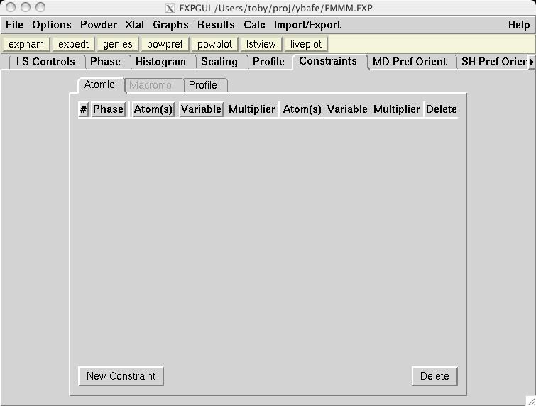

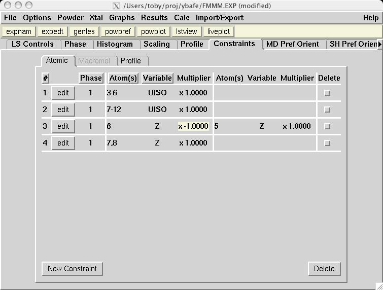

At this point an initial fit of the structure is performed (although some researchers might delay this until the magnetic modeling is included). While under normal conditions, it would be wise to add refinement of variables over the course of several refinement runs, in this case the model is quite stable with respect to refinement and this can be done in a single run. Before starting the refinement, however, Uiso values for like element types are grouped together to reduce the number of parameters. This is done with the Constraints panel (screen image).

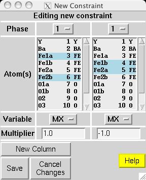

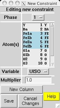

  • To set up the constraint on the Fe atoms, Press on the "New Constraints" button, then select them by dragging over them with the mouse and select UISO in the Variable menu button (screen image) and press "Save".

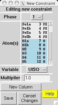

  • Repeat this with the O atoms, Press on the "New Constraints" buttton by dragging over those atoms with the mouse; then select UISO in the Variable menu button (screen image) and press "Save".

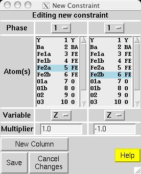

  • Now create a constraint to link the positions of Fe2a and Fe2b, by pressing on the "New Constraints" button, then in the new window press the "New Column" button. In one column, select atom Fe2a, variable Z and multiplier 1.0 while in the column, select atom Fe2b, variable Z and multiplier -1.0 (screen image).
  • For O1a and O1b, the z coordinates must move in the same direction (since they are generated as z/2 and -0.5+z/2). This is done by pressing on the "New Constraints" button, then selecting atom O1a and O1b, variable Z and multiplier 1.0 (screen image). The Constraints panel will then list the four constraints (screen image).
As mentioned previously, the 0.25 values for O atom coordinates are not special values in Fmmm and must be constrained. This must be done with EXPEDT using the following commands:

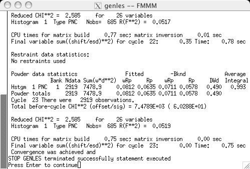

Start Initial Fit of Structural Parameters
To refine the nuclear model, select all atoms on the phase panel (the right mouse button will do this) and click on the X and U "Refinement Flag" buttons (screen image) so that all atom positions can be optimized in addition to 4 Uiso values (1 for the Fe atoms, 1 for the O atoms, 1 for the Y atom and 1 for the Ba atom). Then set the F (fractional occupancy) flag for O4 and O5 only (screen image). Press the "genles" button and note that the fit improves to a chi2 value of approximately 21 (screen image). A view of the fit in LIVEPLOT shows the profile terms need some refinement (which will be done later) and there is significant missing intensity for several low angle reflections (screen image) -- not surprising, since magnetic scattering is not included.

Since the phase type has been changed, it is necessary to run POWPREF (screen image). and then GENLES (screen image). The fit improves from the previous chi2 value of approximately 21 to a new value of approximately 15, as the low-angle magnetic lines are now computed with more intensity, as can now be seen in LIVEPLOT (screen image).
Refine Profile Constraints
From the previous LIVEPLOT result, it is clear that the profile is a major source of differences between the observed and computed diffraction data. While it is possible to have different ordering ranges for the nuclear and magnetic ordering, this cannot be incorporated into a refinement with a single nuclear and magnetic phase.
Select the check buttons for GU, GV & GW on the Profile panel (screen image) and then start GENLES (screen image). The fit improves from the previous chi2 value of approximately 15 to a new value of approximately 3.4. Running POWPREF and then GENLES again causes chi2 to drop from 3.4 to 2.8 just due to the expansion of the peak shape range from POWPREF. Subsequent refinement cycles improves chi2 slightly, to 2.6.
Constrain & Refine Magnetic Moment
In most magnetic refinements, one wishes to refine magnetic moments. It should be noted that the Fe1a and Fe1b atoms are symmetry related, as is the case for Fe2a and Fe2b. One could consider treating the two Fe1 atoms as having different moments from the two Fe2 atoms, but this makes little chemical sense, since there is no reason to expect either site to have an accumulation of off-valence Fe atoms. Further, due to the pseudo-symmmetry of the cell, there are few reflections that distinguish the two non-equivalent Fe scatterers. Thus, it is best to treat all Fe atoms as having a single magnetic moment. EXPGUI can be used to set up constraints on the magnetic moments, by creating a new atom constraint on the Constraints panel, where a shift multiplier of 1.0 is applied to MX of atoms 3 & 6 and a shift multiplier of -1.0 is applied to MX of atoms 4 & 5 (screen image). Press the "Save" button and the constraint appears (screen image).
Changing the refinement flag for the magnetic moments must currently be done from EXPEDT, using the following commands:
  1. Y L
  2. A
  3. v 3:6 M
  4. x x x x
  5. x
where command 1) [Y] indicates the correct file has been selected to be edited; [L] enters the least-squares menu; command 2) [A] moves from the least-squares to the atoms submenu; command 3) [v 3:6 M] sets the M flag (refine magnetic moment) for atoms 3 through 6 (the 4 Fe atoms) command 4) [x x x x] returns to the main menu; command 5) [x] exits EXPEDT

 Phase No. 1; Phase has     12 atoms; Title: from /Users/toby/proj/ybafe/YBaFeO_
 Give atom editing command
  (,$,C,D,E,F,I,K,L,M,P,S,T,U,V,X,+,-,*,/) >v 3:6 M
 SER TYPE    X       Y       Z      FRAC   NAME    UISO    CODE  STSYM MULT FXU
             MX      MY      MZ     MCODE
   3 FE   0.00000 0.00000 0.00000 1.00000 Fe1a     0.00655 I XU   MMM     4 000
            3.500   0.000   0.000       M
   4 FE   0.00000 0.00000 0.50000 1.00000 Fe1b     0.00655 I XU   MMM     4 000
           -3.500   0.000   0.000       M
   5 FE   0.00000 0.00000 0.17002 1.00000 Fe2a     0.00655 I XU MM2(001)  8 000
   6 FE   0.00000 0.00000 0.32998 1.00000 Fe2b     0.00655 I XU MM2(001)  8 000
            3.500   0.000   0.000       M
  (,$,C,D,E,F,I,K,L,M,P,S,T,U,V,X,+,-,*,/) >x x x x

The refinement is then started with GENLES. The magnetic moments shift only slightly (as can be seen from the LSTVIEW output) and the chi2 value drops only slightly (screen image).
