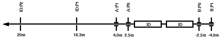

For sectors with double insertion devices, or other pv naming peculiarities, I have made special files:
IDxbpm2.adl
IDxbpm3.adl
IDxbpm4.adl
IDxbpm11.adl
IDxbpm14.adl
IDxbpm34.adl

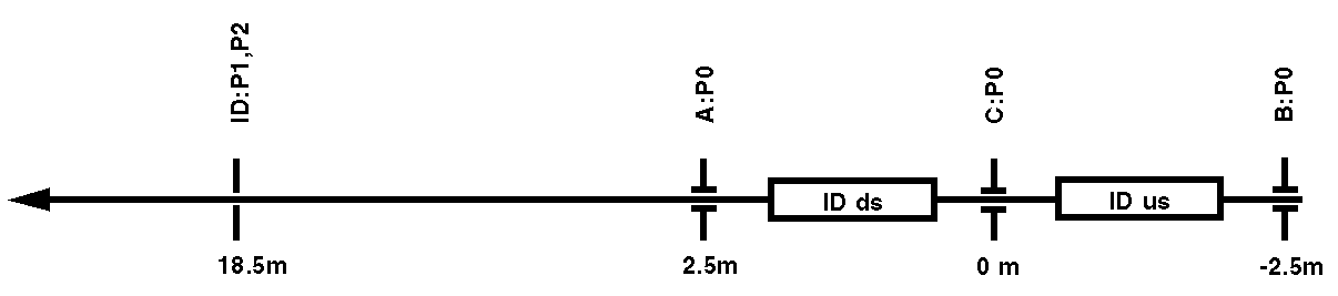

For the canted undulator beamlines, the files to use are
IDxbpmCantedUS.adl
IDxbpmCantedDS.adl

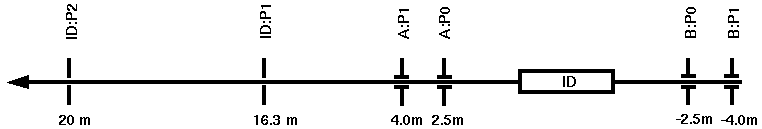

The command
medm -x -macro sector=7,sectorPlusOne=8,sector0=07 IDxbpm.adl
brings up the 7ID display. Just plug in your sector, sectorPlusOne and sector0 values.
The sectorPlusOne designator is necessary because beam position monitors from
both sectors 7 and 8 are needed for the 7ID source point for example.
If you live on an id beamline in sectors 2,3,4,11, or 14, or 34 simply replace the file IDxbpm.adl with e.g. IDxbpm14.adl, and you'll get both ID gaps to show up.

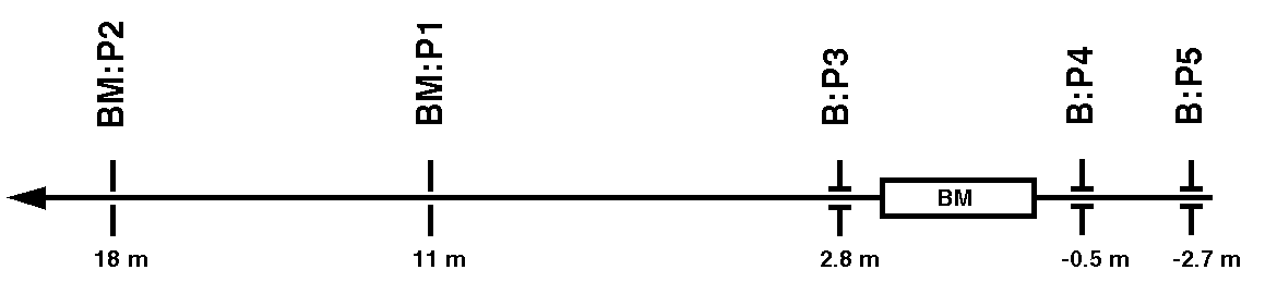

BM lines:
medm -x -macro sector=1,sector0=01 BMxbpm.adl
medm -x -macro sector=2,sector0=02 BMxbpm.adl
medm -x -macro sector=5,sector0=05 BMxbpm.adl
medm -x -macro sector=6,sector0=06 BMxbpm.adl
medm -x -macro sector=7,sector0=07 BMxbpm.adl
medm -x -macro sector=8,sector0=08 BMxbpm.adl
medm -x -macro sector=9,sector0=09 BMxbpm.adl

medm -x -macro sector=21,sectorPlusOne=22,sector0=21 IDxbpmCantedUS.adl
medm -x -macro sector=21,sectorPlusOne=22,sector0=21 IDxbpmCantedDS.adl
medm -x -macro sector=22,sectorPlusOne=23,sector0=22 IDxbpm.adl
medm -x -macro sector=23,sectorPlusOne=24,sector0=23 IDxbpmCantedUS.adl
medm -x -macro sector=23,sectorPlusOne=24,sector0=23 IDxbpmCantedDS.adl
medm -x -macro sector=24,sectorPlusOne=25,sector0=24 IDxbpmCantedUS.adl
medm -x -macro sector=24,sectorPlusOne=25,sector0=24 IDxbpmCantedDS.adl
medm -x -macro sector=26,sectorPlusOne=27,sector0=26 IDxbpmCantedUS.adl
medm -x -macro sector=26,sectorPlusOne=27,sector0=26 IDxbpmCantedDS.adl
medm -x -macro sector=30,sectorPlusOne=31,sector0=30 IDxbpmCantedUS.adl
medm -x -macro sector=30,sectorPlusOne=31,sector0=30 IDxbpmCantedDS.adl
