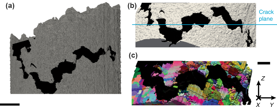

In the past, engineers learned about metal failure by analyzing the separated pieces of a fractured component. But now there are new tools to help solve this old problem. For this paper, the researchers experimented with nickel (Ni)-base superalloy 725. Although engineered for high strength and corrosion resistance, the alloy is very susceptible to HE fractures. Researchers electrically charged a 1 mm cylindrical sample of alloy 725 with H and loaded it to failure in tension. Within the sample they placed the tip of a large, intergranular secondary fracture. Two non-destructive, synchrotron-based techniques revealed the total crystallographic character of individual grain boundaries, including grain orientations: near-field, high-energy diffraction microscopy (HEDM) to image grain shapes and orientations, and x-ray absorption tomography (XRAT) to reveal the interconnections of individual grain boundaries with crack morphology  (Fig. 1). Both were done on X-ray Science Division beamline 1-ID-B,C,E at the APS, which is an Office of Science user facility at Argonne National Laboratory.
The researchers in this study, from the Massachusetts Institute of Technology, Johns Hopkins University, Carnegie Mellon University, Lawrence Livermore National Laboratory, Argonne, and Texas A&M University identified ten microscopic structures that contained grain boundaries especially resistant to crack propagation from HE. These grain boundaries deflected a propagating crack to a meandering path, increasing the crack’s surface area and the work necessary for it to grow, making the material less susceptible to fracturing.  Nine of these fracture-resistant microscopic structures were “BLIPs,” or grain boundaries with low-index planes, where at least one of the grains had a low Miller index facet. The strongest section of a grain boundary determined the ability of the material to stop or deflect a crack. No cracks were initiated in the sample interior, suggesting that all cracks in the Ni-alloy initiated at free surfaces.
